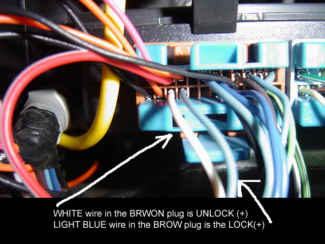

Three (or is it four) plugs at the BCM, under the steering column. You will see quite a few white and blue wires there, though.
In the plug all the way to the left, the locks are in the bottom row----they are the only blue and white that are right next to each other. Supplying a positive trigger to either wire will lock or unlock the doors.
The same wires are also in one of the plugs in the driver's fusebox, if that is easier for you.

Here's a little help for the wires. Use the diagram above to reverse polarity on the (-) trigger output of the alarm system.
