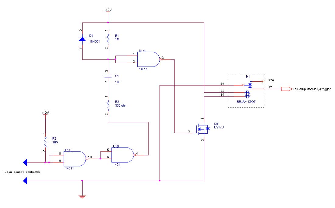

There's probably a commercial one out there, but something like this should work, if you can't find it and want to try making it yourself from a few cheap components-
Rain or water sensor? -- posted image.
Component List >>>
1uF cap
1N4001 diode
RELAY
BS170
10M, 1M, 330 ohm resistors
14011 CMOS NAND gate
Maybe use a pair of header pins for the contacts, which you would put in a shallow tray that would collect the rain water- the idea is that when the water touches both pins, it'll conduct and short the two together, triggering the circuit and briefly closing the relay.
It outputs a single pulse, and won't repeat until the contacts dry out and open the circuit again.

By the way, if your trigger input doesn't really require any current drive, you could probably delete the BS170 and relay shown, to cut down on the parts count.

Sure enough, a google search shows something tailor made for the purpose: rainmain
