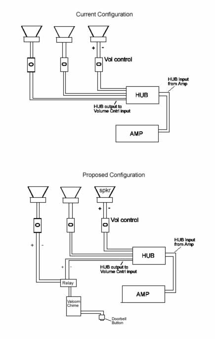

Yes.  I am using a Valcom chime unit (model 9927A) with a simple contact closure setup.  Each of the speakers is attached to a volume control thru a Niles Audio VCS HUB that has internal impedance matching capabilities (which essentially provides continuity to all of the speakers at all times and it somehow internally monitors the circuit to keep it from overloading the amp).
Right now when the speakers are attached to the hub and I press the doorbell, nothing happens unless the volume control for that speaker is turned up.  There is no way I can find to bypass the hub unless i physically remove the leads from the speaker and attach them to the Valcom unit.  What I want to do is remove the speaker leads from the Niles HUB and insert  a relay that is normally closed (thus allowing music to flow through it).  When the button at the front door is depressed I want the relay to open  (which will remove it from the Niles HUB) and momemtarily re-route it to the Valcom unit.  Ultimatley I want the doorbell to take priorty over the speaker so that it will chime regardless of whether the volume control is turned on, off, or even if there is music passing through it..
One Button and 3 different outputs?  One one button but three separate speakers (one on each floor).  These speakers are normally playing music or mght be "at rest" with the volume control turned off.

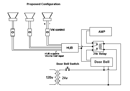

A Schematic would help.  I am not good with drawing schematics although I can read them most of the time.  Here is a block drawing which might give you enough info.  If not...let me know what else I can provide.
Thanks in advance for your time.
Chris

There is such a thing as a 4PDT relay, four separate sets of contacts controlled by one coil.  You should have no problem sourcing a 24VDC coil.  Check out www.Digikey.com.  You should be able to find an 'ice cube' relay, a small squarish relay that is made in a standard package, that you can buy relay bases for.

If you could find where the music goes into the amp you could simply switch between the door bell and the music with a relay.
Mono or Stereo?

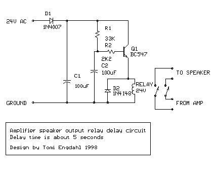

Now if I could only figure out what it will take to keep the relay open for 2-3 seconds.  If I release the button too soon the chimer stops (because the relay is a m.o. and closes as soon as it loses power).  It would be nice if I could press the button and have it remain in the open postion for a bit loger.  Anyone know of a quick--inexpensive fix for this?

This is a delayed on circuit you will have 5 seconds after power is supplied before the power comes on to the relay. If we could reverse the circuit some how. Hmmm Ummm I'll see what else I can come up with.
