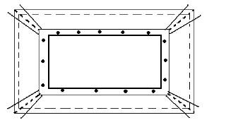

I want to put plexiglass over one of my amps, but I want to mount the plexiglass flush with the box surface.
Can you help me think of ways to do this?
As for now this is the only way I could think to do it.
Flush-mount plexi -- posted image.

A tedious way:  set the glass in and countersink the screws.  Fill with spackle flush with the glass surface.  When you carpet the box, using the double-cutting method for the face of the enclosure...so that all the other sides are carpeted and there is just an inch of overlap onto the face.  This leaves the job of carpeting the face and hiding the edge of the plexiglass under the carpet.  The double-cutting would take place when you meet the front panel of carpet to the overlapped edges.
Before the glass is inserted, glue the edge of a pre-measured piece of carpet onto the inside of the opening on each of the four sides.  These pieces will eventually extend out to cover the face of the enclosure.  Now pull these carpet pieces out of the hole.  Each piece would look something like the four sections in this diagram:
The pieces have been precut to be a few inches longer than they need to be to overlap the edges around the perimeter of the box face.  Now, the carpet itself can be glued over the screwholes, following straight lines created with masking tape.  The carpet, face side, is glued onto the plexigass and creased along the tape.  Now the screws are covered.
When that glue sets, fold the carpet onto itself and extend it out to the perimeter edges of the box.  Use glue to stick the folded carpet onto itself and onto the face.  The plexiglass is flush with the box now except for the folded double layer of carpet.  If you take this into account before you use the router, you can make the cut deep enough to include both the thickness of the glass and the thickness of the folded carpet.  This will give you a completely flush appearance.
The new dark rectangle in the center represents the edges of the folded carpet covering the screws.

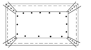

The rest is just doublecutting the carpet pieces into each other, shown where I put dotted lines in the pic.  Every piece is larger than it needs to be and overlaps the adjacent piece.  These overlaps are cut to form a blended carpeted face.  A lot of masking tape and precise work this is.  And I don't know what ever possessed me to go to these lengths to explain my vision!
coppellstereo
Silver - Posts: 785
Joined: November 21, 2005
Posted: December 01, 2005 at 12:46 AM / IP Logged
that sounds like a good idea!
Even though setting the router to account for the thickness of the folder carpet, this is a lot better than the alternative in my opion!
What kind of glue would work to glue the carpet to the plexiglass?
Thanks for such a great post!
