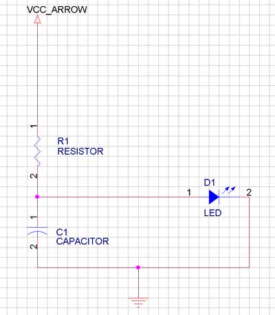

What are you using to drive the LEDs with?
If it really burns out every time you reconnect them, but are fine otherwise, only thing I can think of may be that your circuit has some capacitance on the output that results in a large current surge being applied to the LED and blowing it out. When it's in circuit, the normal resistance limits the current.
Just speculation, you have to see how you've got it connected-

Yeah, I assume the limiting resistor is in place if it works for a long time while it's hooked up, and only blows if it gets reconnected.
If it were hooked up in some funky way like this, it could blow on reconnection, since the cap would charge up to the full 12V and blast the LED with a big current surge, assuming the cap were large enough.
Add on alarm LED opinions -- posted image.
Other thing might be electrostatic discharge, but LED's aren't particularly sensitive to that, so I doubt that would be it.
