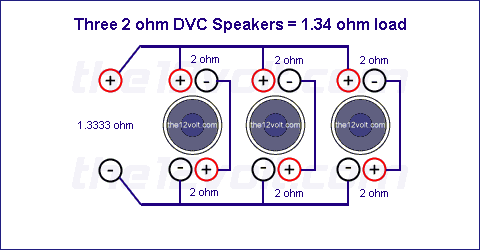

Three 2 ohm DVC Speakers = 3 ohm load=voice coils wired in parallel, subs wired in series.
couldnt you wire this setup exactly opposite to get a little lower resistance?
   i mean could you wire the voice coils in series and subs in parallel and get between 1 and 2 ohms? thats about the calculations i get from my best memory of my principles of technology classes and math classes.

oh ok.    i guess i didnt scroll down far enough in the wiring page.     sorry for the wasted space...

We'll let it slide- just don't let it happen again, huh?  three subs wiring options? -- posted image.
