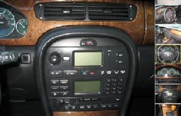

02 Jaquar X-Type Factory CD Changer -- posted image.
DYohn,
Thanks for all the info. However I wanted to make sure we are on the same page so I posted a pic of the radio. I know I pressed the CD button more than twice, but I do not remember CDDJ coming up on the screen. I am beginning to think it is the changer itself as I recall not hearing it load.

Yes, that looks like the Visteon designed unit.  The changer has to power on for the HU to "see" it.
