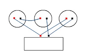

If he wires 2 subs in series to get an 8-ohm load, and wires the 8-ohm load to the 4-ohm load in parelell to the 3rd sub, wouldn't that result in a 2.67 ohm load.
Although the load on the amp would be what you state (8ohm paralleled with 4ohm), the power distribution to the individual subs would be totally whacked out.  This diagram is essentially the hookup you described.  (Note that with parallel connections they are the same whether connected directly to the speaker or directly to the amp, as same polarities are all connected):
tips for speaker box -- posted image.
The amp would be outputting at a 1:2 ratio into the two different loads, into 8 ohms and into 4 ohms.  The speaker on the right (#3) is a 4 ohm load so it would receive twice the power as #1 and #2 combined who together make an 8 ohm load.  You can see the results with this example scenario:
Say that the amp is rated at 500 watts into 4 ohms.  You determine that it will output approximately 800 watts into a 2.67 ohm load.  Ideally, you would want that 800 watts to be split evenly among the three subs for 267 watts each.
The amp outputs 800 watts because it reads a 2.67 ohm load.  But the power into sub #3 is twice as great as the power that is going into #1 and #2 combined.  That's because 1and 2, as a wired set at 8 ohms, have an impedance that is twice as great as #3's 4 ohm impedance.  So the power distribution with your proposed wiring scheme would be:
  • sub #1 = 133 watts
  • sub #2 = 133 watts
  • sub #3 = 533 watts

Ok,  that makes sense.  I kind of thought something like that after I posted after I thought about it a little more.
