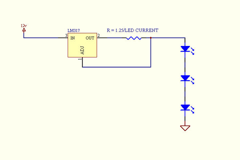

Heres a real simple circuit that uses and adjustable voltage regulator as constant current regulator. When using a constant regulator the voltage can vary without the led brightness changing. This is useful with white LEDs since their brightness can vary greatly with a small change in voltage. Plus you can add LEDs in series without changing the resistor value. You can still get LM317 regulators at radio shack.
The only limitation is that the total foreword voltage of the LEDs in series must be at least 1.5 volts lower than your battery voltage.
A worked example for 3 typical red LEDs:  LED foreword voltage = 2.2, current = 30mA
For the resistor, 1.25/0.030 = 41.6 ohm.  And at 12 volts you can drive up to 4 LEDs.
getting the maximum out of LEDs -- posted image.
