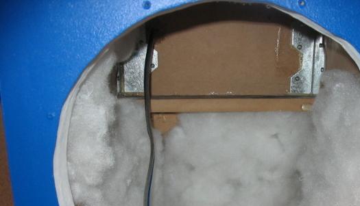

I've always been told that any piece over 12" needs to be braced (including the slot port). I just built a box very similar to that and used 10 metal corner braces from Home Depot (about $1.50 each). They take up very little volume so it shouldn't affect the calculations you have already done.You can see a couple in the pic I attached.
You might also want to think about sticking an extra piece of mdf where the sub is going. It gives some extra bracing and allows you to use longer screws without them going all the way through.

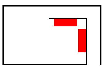

Oops, guess I was a little unclear on bracing the slot port. Don't brace it on the inside of the port. Brace it on the outside like in this pic...
