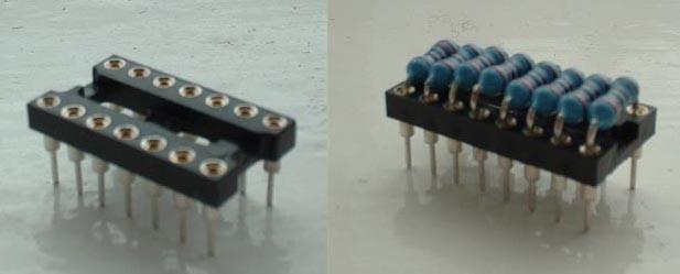

I've got the tools and experience to be able to desolder/solder my own modules. But that link I posted above actually shows the guy using solderless Turned Pin IC Sockets (0.3in 16 pin). Pretty cool stuff and I am trying to track down someone who sells them in the US.
With the turned pin IC sockets you should only be out a couple bucks for each module including the resistors. The coolest part about them is they are swappable by just popping out the resistors and sticking new ones in it.Audio Control frequency modules -- posted image.

check Digi-Key part numbers ED3316, ED56163,A402AE, or AE7303. they should be what
you are looking for.  i'm lazy and using a catalog for the part numbers.  and of course you can

Thanks Ween! I ordered one of each so I'll post up when I figure out which one is an exact match.

Got an update... one of the sockets was a perfect fit. Not bad for $1 each, gold plated too.
Okay, here are the part numbers from DigiKey:
IC SOCKET 14 PIN .300 GOLD (18dB) Part #ED56143-ND
IC SOCKET 16 PIN .300 GOLD (24dB) Part #ED56163-ND
Go to page 1157 of their online catalog for the resistors. You want the ones at the very top of the page and they are about .10 cents each.
Yageo 1% Metal Film Fixed Resistors 1/4 watt
Pick the kohm rating that you want and the part number should be something like this... 142KXBK-ND (that is a 142kohm resistor).
http://www.digikey.com/
*EDIT: You might also want to add an extractor tool to make removing these sockets a little bit easier. Part #K157-ND ($3.64)
