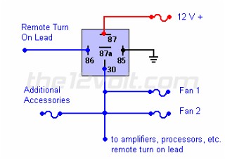

3.  Use the relay diagram shown here:
3 amps, how to wire? -- posted image.
The curved S-shaped symbol represents a fuse.  Fuse each of the accessories at a higher rating than their amperage draw.  The red line is 12V power source and is normally attached at the battery.  This wire is fused for protection as well, and will be rated high enough for the combined current draw of all accessories.  These currents are low, mind you.  An amp uses only about 1/4 amp to turn on, and fans use very little too.  Look at their amperage rating and add them all together.  This main fuse will protect the relay.
The wire marked "remote turn on lead" is attached at the deck.
More info:  https://www.the12volt.com/relays/relays.asp
https://www.the12volt.com/relays/page5.asp
https://www.the12volt.com/relays/page5.asp#rtol

The fuses and fuseholders for the wires to the fans:  total cost $5 anywhere.  This little fuseholder is 49 cents apiece and a pack of small amperage fuses a couple of bucks.  This pocket change is all you can get by with omitting if you were going to leave anything out of this install, and is that worth it?  I would fuse each wire as shown.  In the long run when you are trying to troubleshoot a problem with one component in the long chain of components that make up the entire sound system, you are much better off with the proper setup to work with.
There are no shortcuts when it comes to fusing the power wires out of the distro.  You can make smart choices in what you buy though.  A fused block isn't necessary, but the wires need a fuseholder after the block and before the amp.  You can use the block you already have and do some smart shopping to keep costs down on these important and necessary safety items.
