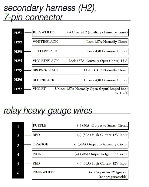

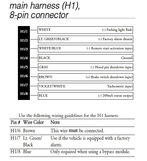

I am trying to install BOA 265B remote starter with keyless entry for my nissan maxima but did not have any luck.
Here is the info of the BOA 265B Harness
96 maxima remote start w/keyless entry - Page 2 -- posted image.
step 1 Ground Wire: The BLACK (H1/4) wire on the main 8-pin harness is ground, So I hook it up to clean metal in the drivers kick panel area.

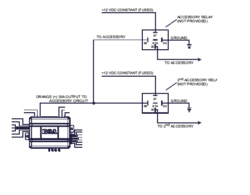

step 4 Accessory wires:  I connect the thick ORANGE wire of the heavy gauge wires to the 1St Accessory(RED / yellow) and 2nd Accessory wire (blue). Refer to the diagram below.

However, I by passed all these connection "Safety Shutdown Wires, Hood Pins, Parking light Fash, and Door Locks" just want to test the remote start first to make sure it 's working before continue to connect the rest later on.
So I hooked up all the wire as I mentioned above ( step 1  to 5) and I got nothing,  the remote start is not  working. I just wonder is it required to hook up all the wire to get the remote start working or Is there something that I missed. Please help.
Any help would appreciated
Thank you
