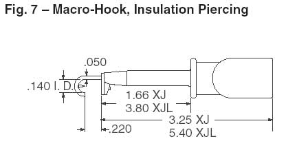

If you frequently need to probe unknown wires, something like this would be good- available from digikey and various other places.
I usually would just use a pin to make it through the insulation with the minimum amount of disturbance, but the insulation piercing test probe is a lot more finger-friendly..
This one is twice the price, but it's got nice extended tips to reach into a bundle, and you can just connect it to your meter with the banana jack-Just slip the wire in and push to probe.
