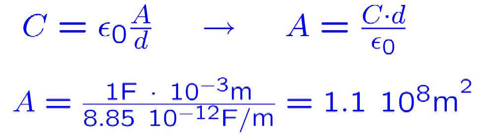

Also, the foil surface area involved in a 1F electrolytic capacitor is MONSTROUS... HUGE! Here is the faormila for figuring the surface area for a capacitor:
should we build 1 farad cap. our own? -- posted image.
(Credit for this formula goes to this website...
1,100,000,000 square meters of area for a 1F vaccuum (dielectric constant of 8.85, the 8.85 can be replaced by the dielectric constant of whatever insulator you choose - the higher the better) capacitor with plates separated by 1mm (the 10^-3 number in this formula. Again you can substitute whatever you plate distance is - smaller is better) If you reduce the plate separation to .1mm, your number becomes 110,000,000 square meters. Still a HUGE number. Do you see where I am going with this? You WILL NEVER be able to build a 1F capacitor in your garage... Forget it... DO YOU have a manufacturing facility with the accuracy to place 110,000,000 square meters (that's 2 PIECES 110,000,000 square meters large, BTW) of foil .1mm apart, and then roll it up? Didn't think so... Even *I* dont have that kind of stuff in my garage! LOL
