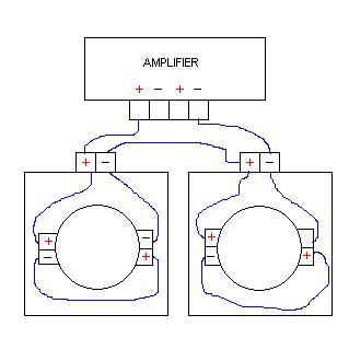

My friend kept arguing with me about the way to wire my subs. I gave in and wired it "his way" which is the one in the diagram I have drawn. That doesn't look like 4ohms bridged. I think it should be wired the way you guys were telling me which is-
Subwoofer & Amp Wiring - Page 2 -- posted image.
Basically, I just want to bridge my amplifier and have everything work out to be 4ohms to produce 400watts rms. Which is truly the right way?
Thanks again guys, -Paul

the first diagram you have will produce 16ohms, the second one will prodice a 4 ohm load on the amp. You can proceed with rubbing it in your friends face Subwoofer & Amp Wiring - Page 2 -- posted image.
