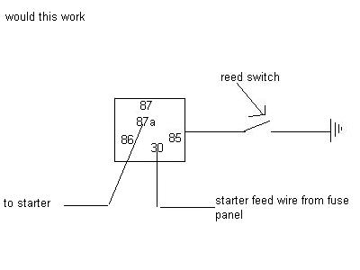

Relay and switch? -- posted image.

sorry just thought about it and it would not work.

you almost have it. Connect 12vdc constant power to the 86 post.  You make also want to protect the 87 post from accidentally grounding...

i probaly would understand it better if i uderstood more how a relay works. i have to read some more.  So when you put 12volts to 86 the relay is pulled  open and when you ground  # 85 THE REED SWITCH it closes to make the connection. Correct

Connecting 12 volts to 86 doesnt complete the circuit. The circuit will be complete when the reed switch is closed( when you put a magnet near it)and there is 12vdc to the 86 post, and there is chassis ground on the other side of the closed reed switch .
When this circuit is complete, it energizes the coil and connects 30 (Common) to the 87 (Normally Open). This also Diconnects 30 from 87a (Normally Closed)
A relay is two seperate circuits. posts 85 and 86 are one circuit. Posts 30, 87, and 87a are seperate circuit. The 12vdc from 86 and 85 dont provide power to 30,87, and 87a
I hope this helps a little bit.
