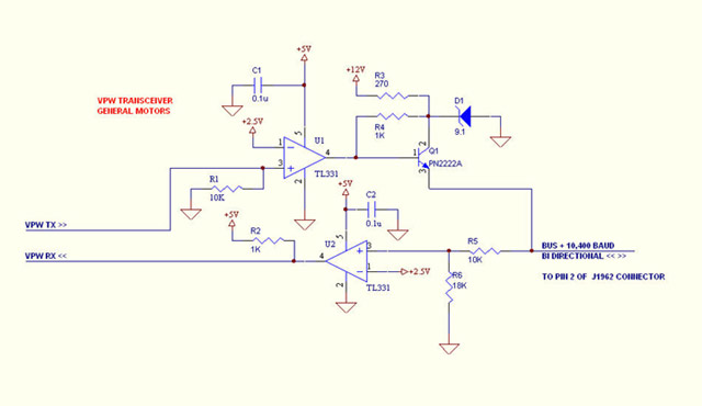

If you give the model and year of the car I can give you a simple circuit to interface a serial port to the OBD connector.

1997 grand am SE

firstrax
Copper - Posts: 113
Joined: January 18, 2006
Posted: January 19, 2006 at 9:32 PM / IP Logged
total_overkill wrote:
1997 grand am SE
thanks
Then you have a VPW (variable pulse width) system. Its a one wire system.
A logic 1 is a passive line for a period of  128us or an active line for a period 64us.
A logic 0 is the exact opposite.
No start bits or stop bits, just data bits with no interbyte spacing.
Typical data request would be: 68 6A F1 01 05 (Requests coolant temperature).
SAE documents J1979 (codes) and J1850 (protocol) will have everything you need.computer to get all engine diagnostics? -- posted image.
