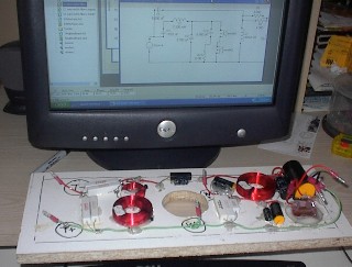

Frequency Response Data Consortium  is where you want to go with this project.  Some of these tools use the MS spreadsheet and some are stand-alone.  When I design a passive network for mids-to-tweeters, I use these:
  • SPL Trace copies the manufacturer's freq response and impedance curves.  Vifa supplies these and you should find them online.  This becomes your model for the crossover design.
  • Speaker Workshop to design the crossover.
  • Unibox to design the enclosure for the mids and subs.
And there are several more tools as well, as you will see, but you can pick and choose which ones you want to use.  Here's a pic I took showing Speaker Workshop on the computer screen, and the almost-finalized crossover layout for the project I was working on.
Wiring amps & crossovers -- posted image.
There will be some time involved in learning how to use these design tools, so put into it what you want to get out of it.  The values for caps, coils and resistors will most likely be different than what you already bought, since you apparently purhased the components without first designing the crossover.  These parts can get pretty expensive, but when you are trying to work with values that are not quite what the program indicates is best to use (the parts you already bought), you will spend a considerable amount of time trying to get it to work out.  So, when you come up with the final design, just buy the new components and stash whatever you have left over for possible future use.
Otherwise, you can use the active filters on the amps to cross over the mids to the subs.
