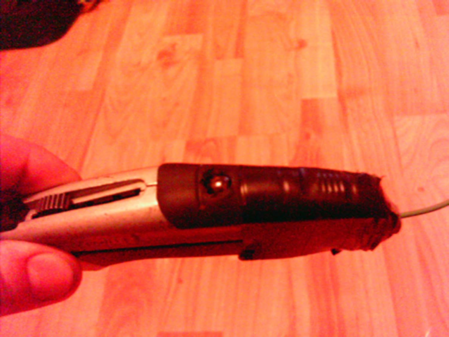

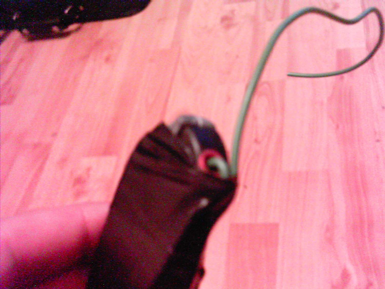

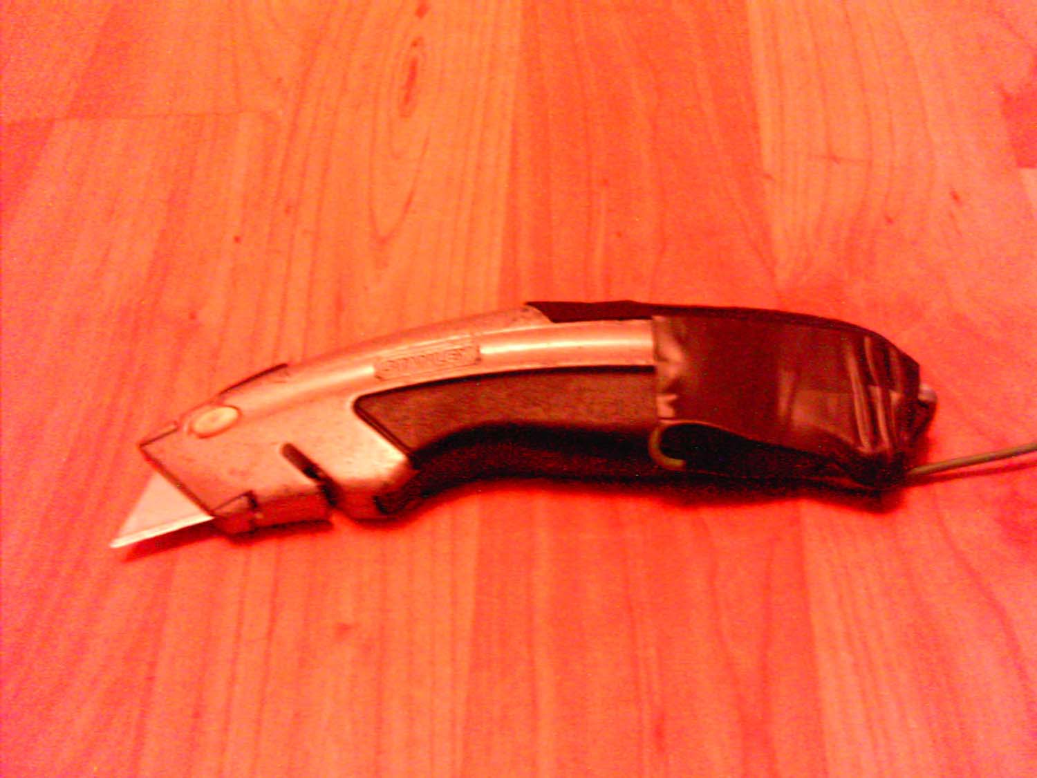

ok folks it along time coming but i finally got around to it. here is the pics of my stanley knife that some of you espressed interest in.
i only had a shhhty little camera here so please excuse the quality of the images.
i use this knife a couple of differt ways.
1. i hook up like so to a DMM and can cut into wires to take reading. (this the the method i use most)
2. i have the bulb installed and can use it as a test light.
3. sometimes for locking i connect my power probe and can apply current through it.
as you can see i have a butt connector installed in the bottom of the knife for easy connection although i just have some wire installed in the pic. i didn't take the knife apart for the pics as it can be a pain to get back together and i don't want everyone seeing the mysteries within LOL.

so how is the wire attached to the knife?

lol in the pics its just stuffed in hadn't got my butt connector attachment with me the other day.. so had to improvise

Although my Stanley isn't as nice as yours, been using the Stanley knife method for years.  But I have to put the probe of DMM or Test Light in the back where I drilled a hole.............

I just drilled a hole and mounted the butt connector
done some continuity testing then.
