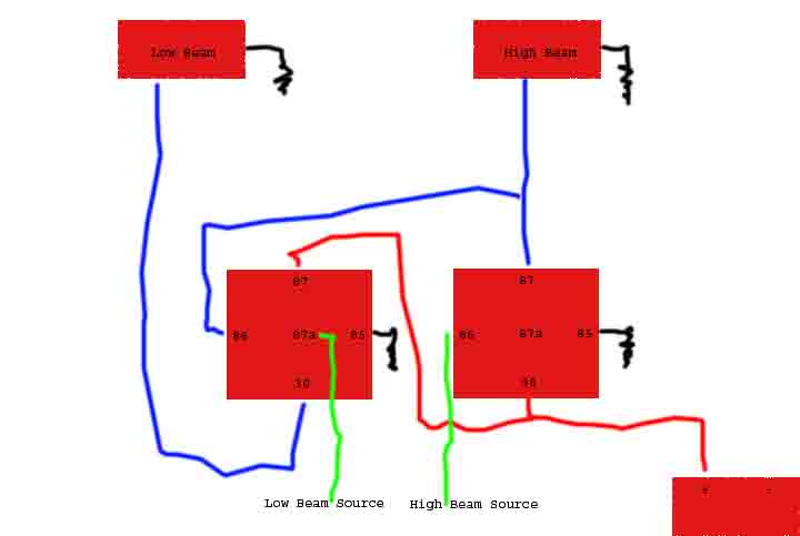

I think this is the way to do it. Just let me know but this seems right to me even though I really don't know for sure Driving lights on with high beams -- posted image.
I think this is correct please let me know but I think I got it.

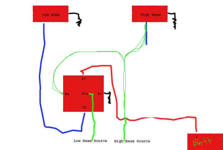

you actually need only one relay, move the high beam source to 86 (just pigtail it off the existing wire)
There are 10 types of people in the world, ones that understand binary and ones that dont.
infinkc
Copper - Posts: 438
Joined: October 28, 2002
Posted: January 25, 2006 at 8:00 PM / IP Logged
your diagram is also correct if you wanted to run direct power from the batt to the high beams also, but i dont see why it would be necessary since the low beam source is still being used also for powering the low beams

yeah I only bought 2 relays so until I get another one I will run power for driving lights
But yeah I meant to add the second relay so I would get direct power with both lights on
Glad to hear I got it right I have been fussing over this all day HAHA

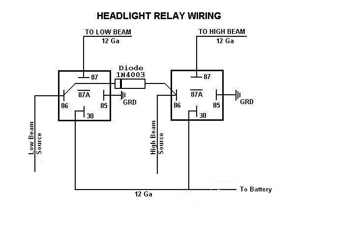

Here's an example of how to run both light systems directly off the battery source, with two relays and one diode.
turboman808
Member - Posts: 6
Joined: January 25, 2006
Posted: January 25, 2006 at 9:50 PM / IP Logged
how that looks like it would be so much cleaner to do also. I can just pick up the diode at any radio shack. What does that do exactly? Only left power go thru in one direction?
gimme back my bullets
Hoptup32
Copper - Posts: 87
Joined: December 25, 2004
Posted: January 26, 2006 at 7:35 PM / IP Logged
You're right, the diode only lets the power flow one-way.  When the hi-beam source is utilized, power flows thru the diode and activates the low beam relay. When the low beam source is utilized, the diode blocks the power from going over to the hi-beam relay.
turboman808
Member - Posts: 6
Posted: January 27, 2006 at 11:06 AM / IP Logged
I followed your drawing and everything works great. Thank you very much. Driving lights on with high beams -- posted image.
