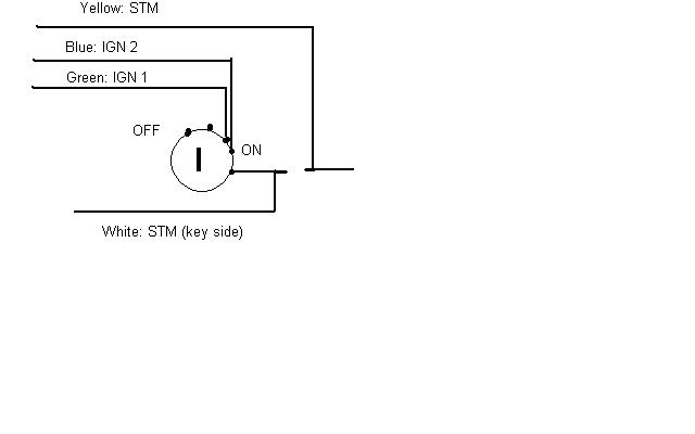

2000 Audi A6 remote start -- posted image.
If the Menu book show like that how  can i wire the 2nd starter wire

Well according to the astrochart from canada you don't need 2 starter wire  The BAT = RED    IGN = BLACK   STARTER = RED / BLACK   ACC = BLACK / YELLOW   Those the same color for a Volkswagon
