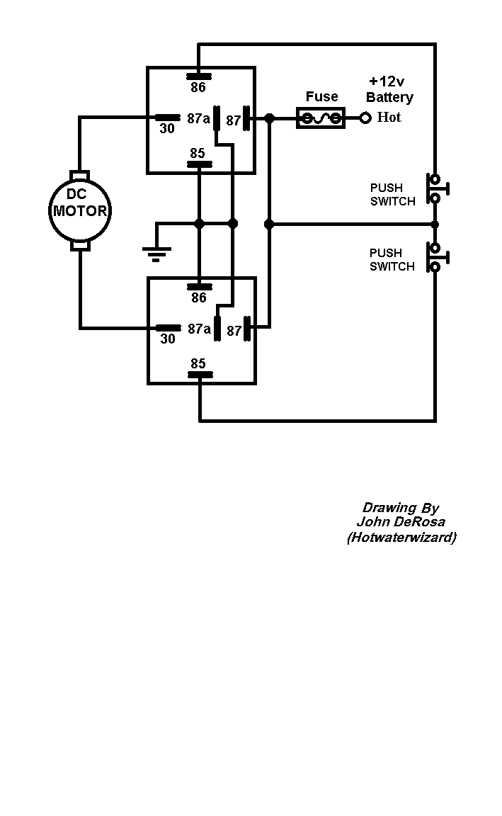

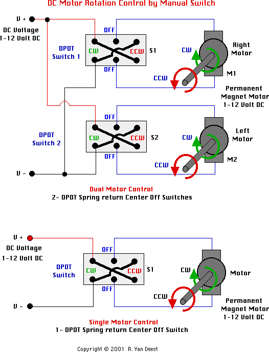

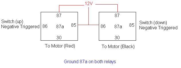

I am in the process of moving the power window switches from the door to a center console. These are 5 wire switches from GM and I want to use something else. Either toggle switches or (?) some other suggestion.  Any help would be appreciated along with any diagrams that are required.  Thanks

easiest way i can think of integrating a better type of switch is get an aftermarket window module, once hooked up to the window motor wires you can control the windows up and down by just pulsing the trigger wire with a negative trigger. you can use any type of switch in this case that is momentary

Simple diagram for Power Windows -- posted image.
