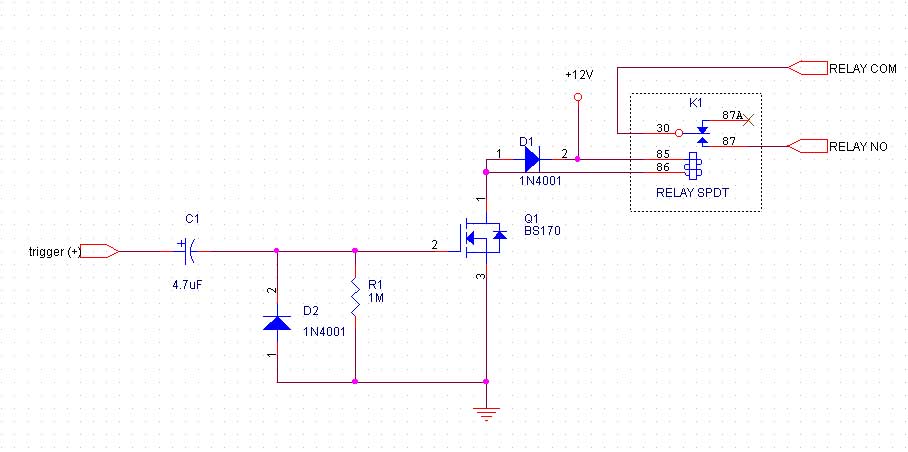

Pretty easy to make one up, use a BS170 MOSFET to drive the relay coil, with an inline cap to drive the transistor high briefly. Then a pulldown resistor attached from the gate to ground turns it off after your time delay. I'll draw it up later and post it-
Here is is-
Need a 5 sec. time delay off -- posted image.
Just use a bigger cap or resistor to get a larger on time, and vice versa.
This assumes your (+) trigger input is at least 5 seconds; if you want it to output the same pulse even with a short trigger, then the circuit would need some mods. Since you said it would be constant, I figure it won't be a problem.
It won't turn on again until the input goes to ground, and then goes back up; then the relay should kick in for another time period.

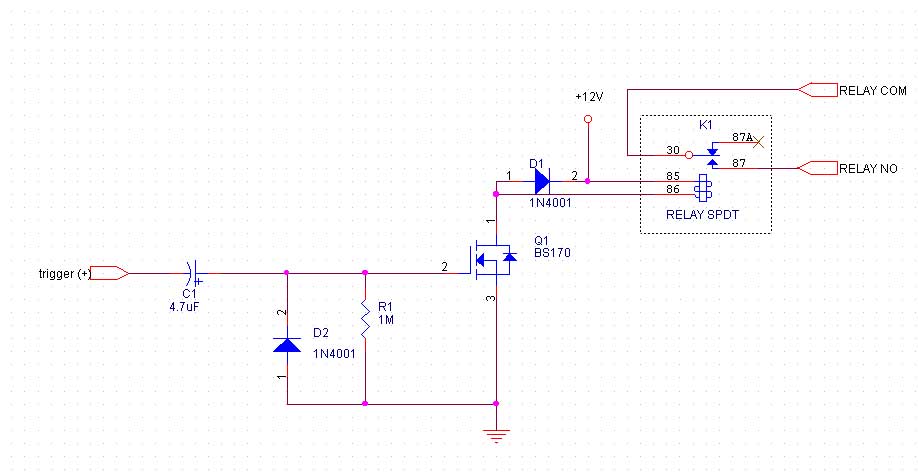

Seems like the edit feature comes and goes on this board- if you use a polarized cap, the polarity should be switched as in this updated diagram-

After doing some testing, I've found that I need a 3 second output (instead of 5 seconds).
So, dualsport, what components/values, etc., do I need to change or modify in the above (updated) diagram to get a pulsed ouput to hold the coil of the relay between 2.75 minimum & 3 seconds max?
