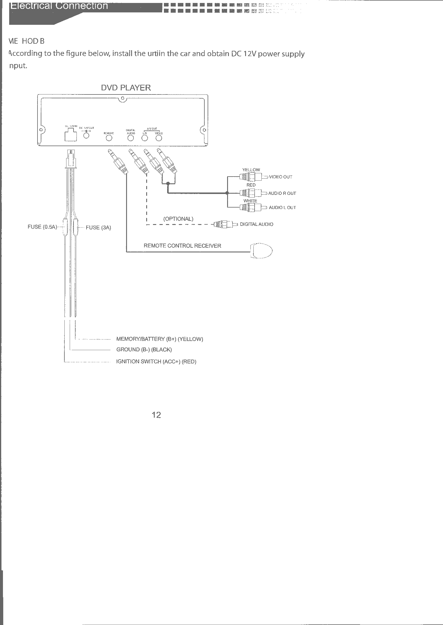

So I DL'd the instruction booklet for the 05N to see what it was all about and it shows how to hook it up to the power supply and I'm somewhat confused with how to hook it up.  I will attact a scanned picture of the image.  I know hook up the ground to ground.  But it showsl "Memory/Battery (b+) (yellow)" and "Ignition Switch (ACC+) (RED)"  I'm assuming the battery one goes to battery but I don't know what the ignition switch is all about?

If you are asking what to connect the wires to.
ground to ground
memory to a 12v constant
ignition to accessory
