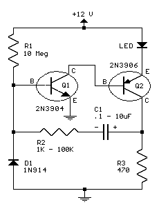

How can I wire up a flasher circuit to flash something with very low currnt, like a relay. I've wired up a flasher circuit before using a relay and a two prong electronic flasher, but I can only get it to work in a high current application like for flashing parking lights.
hotwaterwizard
Silver - Posts: 1,350
Joined: December 11, 2003
Posted: February 19, 2006 at 7:02 PM / IP Logged
Low current flasher circuit -- posted image.

CutDog504
Silver - Posts: 643
Joined: May 14, 2002
Posted: February 23, 2006 at 1:02 AM / IP Logged

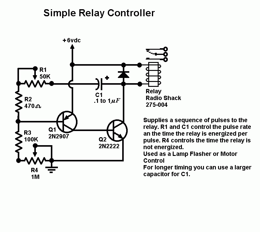

Could you explain this to me? And is this only for low voltage LED's or will this circuit trigger a 12v relay?
hotwaterwizard
Posted: February 23, 2006 at 8:28 AM / IP Logged
Ok now I get it you want a relay controller.

Posted: March 08, 2006 at 8:59 AM / IP Logged
This diagram is confusing to me. I dont understand the symbols. And what does r1 and r2 and q1, q2 mean, or what do they represent. Could you explain this diagram
(translate it) for me?
hotwaterwizard
Posted: March 08, 2006 at 9:42 PM / IP Logged
Q is a Transistor  the numbers represent the Part Number
R is a Resistor the numbers represent Resistance Value in Ohms
C is a Capacitor the numbers represent the capacitance in Microfarads
the other symbol a Diode
