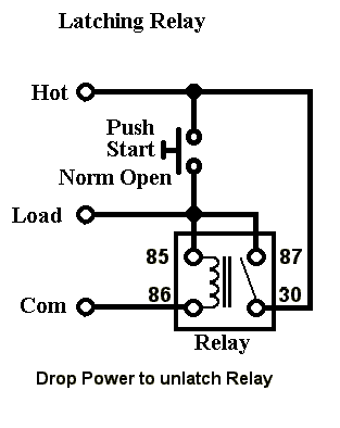

I need some help with a positive pulse switched circuit in a 12volt system.  I have a strobe power supply that when switched on should be always powered.  when a "dimmer" circuit is activated, I need the same circuit to switch off until the circuit is shut off then back on to restore it to normal operation.  The dimmer circuit is activated with a momentary positive pulse.  Any help will be greatly appriciated.

+ Pulse switched circuit -- posted image.
