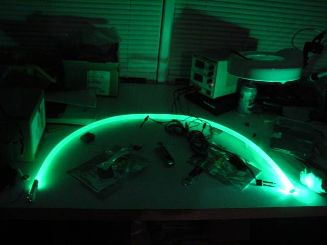

Heres an example of side emitting fiber using a single led.
One benifit to led is no high frequency power supply to possibly leak into the audio signals.

coppellstereo
Silver - Posts: 785
Joined: November 21, 2005
Posted: March 12, 2006 at 8:29 PM / IP Logged
that is with ONE LED??
wow.

The LED is a pre-production sample K2 led. Driven @ 1400 mA.
The fiber is 7mm solid core.
