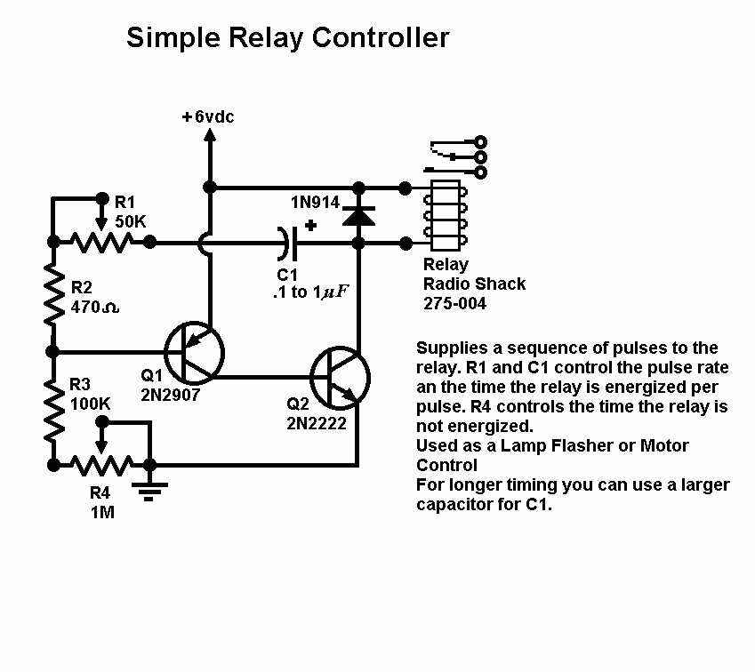

I have a salt spreader and need a way to  time the on-off. For example, Turn on and the salt spreader will cycle thru a adjustable lenth of time (in seconds) turining on for a set time and off for a set time again in seconds.
Any Ideas?

DEI make a timer relay that has an ajustable time length I use them to run the locking on Ford Mondeo'sA way to delay an on-off -- posted image.
