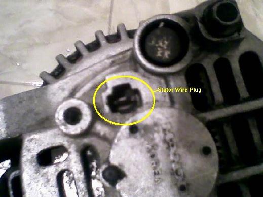

I too want to upgrade to the Big 3 in my '90 Ford PGT. The problem i'm having is the alternator not charging the battery due to the stator wire not being plugged up. I can't seem to find it anywhere in the vehicle. Can anyone please help me out to determine where I'd possibly find this wire.

Nevermind... found out that THIS alternator was for the automatic.  The manual GT didn't have the stator wire as the alternator itself was of a "self-excited" make.   How to Upgrade the Big Three - Page 11 -- posted image.
