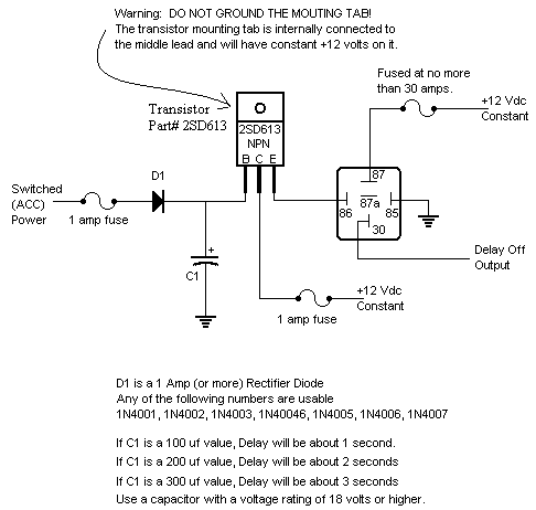

Can someone tell me, using the schematic for constant to momentary in relays special applications, what value capacitor would be needed to achieve a 3 sec output?

you would need a 3 second delayed off timer. This one can be made easy.
Timed reversing polarity circuit -- posted image.

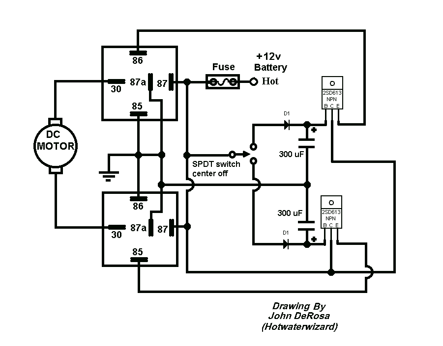

Then you need to figure out how to hook it to the switch without frying it,
Here is a motor reverse switch circuit.

Like this!

If it works let me know.

Thanks. That gives me some great ideas to work with. Won't quite work because that is a spdt switch, and I'm using a spst. So the switch will provide 12v when on, and open when off.
