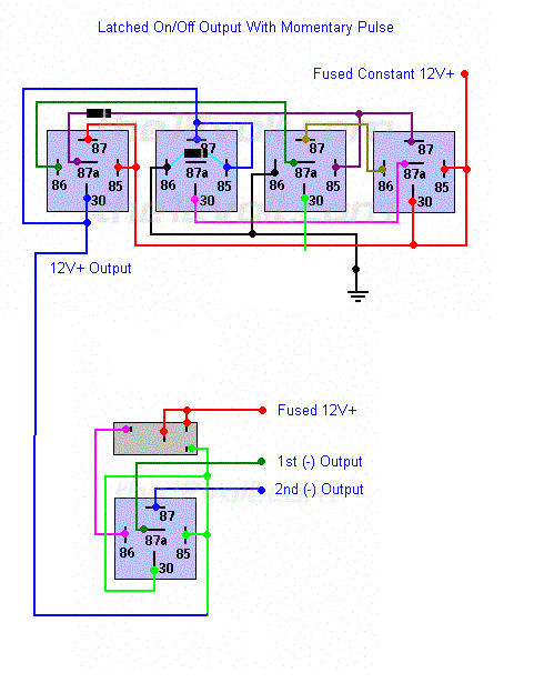

okay, so i saw this diagram..
https://www.the12volt.com/images/latchonoffsp.gif
and was wondering if there was a way to integrate another relay that would introduce the second pulse? i want to be able to have a 2 wire actuator pull and push, with maybe a 1 second interval between the pull and push, with only 1 push of a button.. is this possible?

Using this will give you what to want. You will need to incorporate both diagram together though.

so.. that will put out 2 pulses with 1 input? so all i have to do is put the 2 outputs from that, to the input from the switch in mine? or the 12vout from mine, to the switch in on yours?
