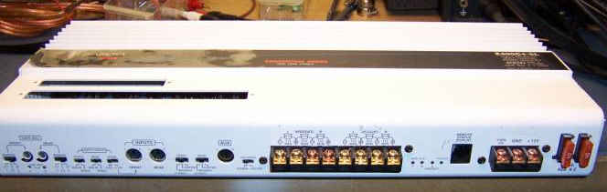

Zapco Z400C4-SL -- posted image.

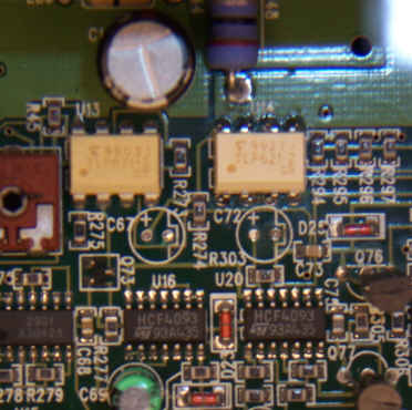

I found a timing issue with a HCF4093 QUAD 2 INPUT NAND SCHMITT TRIGGER located at U20.
The 10uf 50v cap (C72) connected to pins 12 and 13 was making the amp not start all the time. I found this when I removed the cap and the amp started every time. I opted to put a 100uf 50v cap in its place and everything works fine.

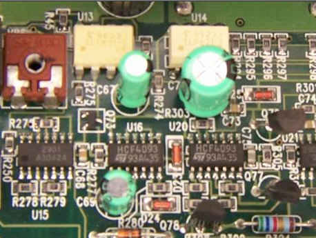

So after replacing all the out-put finals, power supply MOSFET’s, full wave bridge, all 12 SMD op-amps and many caps, it turned out to be just the four leaking caps in the preamp stage and the timing issue. It sucked working on a four layer board without a schematic!, THANKS ZAPCO FOR ALL YOUR HELP! (NOT). Just thought I would share.

Back together…
