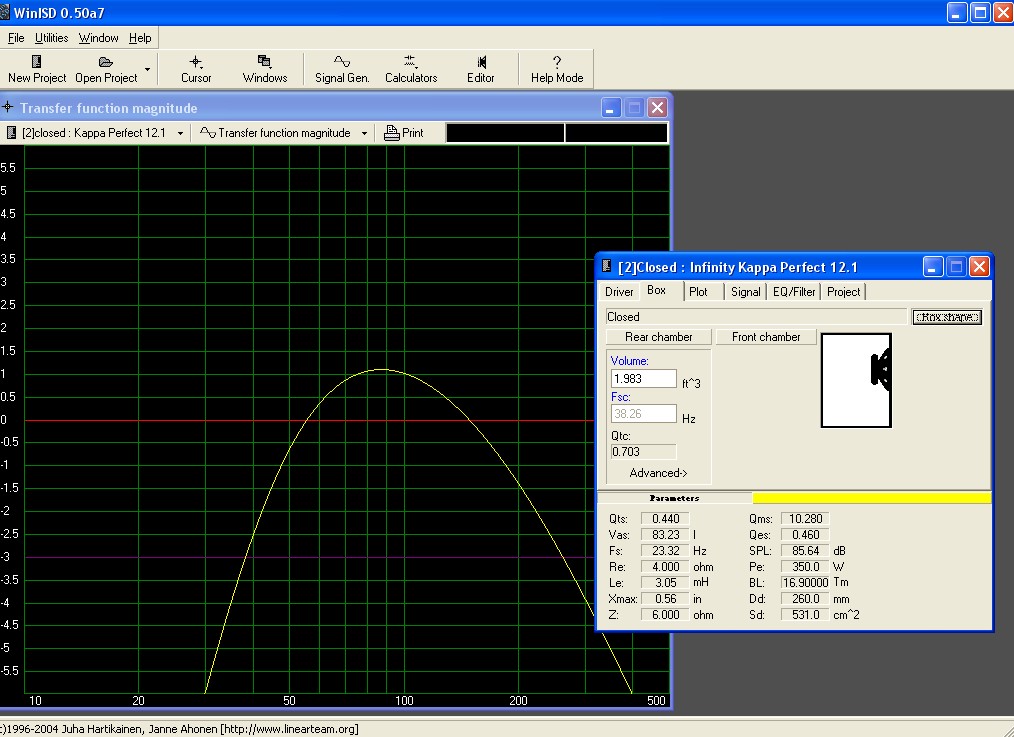

sealedwinisd.jpg Here is a screenshot of a subwoofer taken out of WinISD's database. This sub is best suited for sealed (EBP of 50.7) and the alignment calculated for max flat amplitude response. In other words, as SQ as possible. (Note...when you click on these files you may get a less-than-perfect image. Hover your mouse at the bottom right corner of the screen to make the 'expand' icon appear, click it, and the image will appear full.) With a sealed woofer, take notice of the box labelled 'Qtc' in the inset dialogue box. This is the alignment, or Q, of this woofer/ box airspace combination. If you were to highlight, then change the air volume to try several different volumes, you would see this Q change with every change you make. The value of .707 is what you are looking for here and you want to get as close to it as possible.

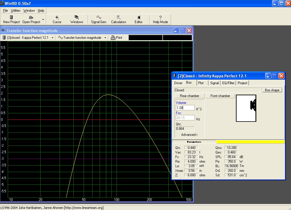

FAQ: "WinISD tells me to use 2 cu ft but I only have room for 1 cu ft. Is this okay?"
Such is the real world with car audio. You should use the program to look at the response in 1 cu ft and see what it tells you: sealed1winisd.jpg When you compare the two pictures, you see that the smaller air space makes this woofer peak another decibel and lose some low end. Look at low end response by looking at the lower Hz part of the chart, specifically at where the line curves across the purple (F3) line. That point would be considered the low end of your sub's response because at that point the power is only half of what it is at 0. Look at the Qtc box; the Q has risen to .86 - a big jump from .70 Do you accept that if you want SQ? No, you find a way to get two cubic feet. Or you look at other drivers in WinISD to find one that has a better Q with 1 cu ft.
The curved line represents the sound from your sub in that amount of airspace. When the line peaks above the flat 0 line, it tells you that there will be more power going to those frequencies within the peak than there will be elsewhere. When the line dips below flat, less power is produced. The peakier the response, the higher the Q, and the less musical the overall sound. There are times, though, when a peaked response is preferred, namely when competing in SPL competitions. When max power is within the range of the vehicle's resonant frequency, the sub may prove to be louder because of that marriage of sound in that range. But you wouldn't use this woofer for SPL comps, you'd choose another.

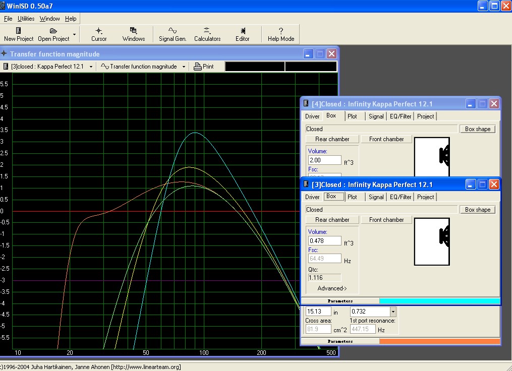

Looking at how you can change units with the mouse, let's go back to the charts. You can change the charts considerably. Right click on the chart and a small box will appear, choose 'Options'. Another box appears and allows you to change the start, end or unit type in any of the charts.
Fiddling the response
Now that you're becoming comfortable with making changes and seeing that nothing has blown up, you can start fiddling with the response from your woofer. Change the airspace to several different volumes, watch the chart for the response, and note the Q. Bring your same woofer up again on the same chart by clicking 'New project', select your driver (it's now on the list), and click through the "New project...' dialogue box making whatever changes your whims allow. Change the color of the response by placing the cursor atop the colored bar in the box and click to select another color for the second response line. You can compare any number of different volumes/ alignments on the same chart by using this method. multiwinisd.jpg

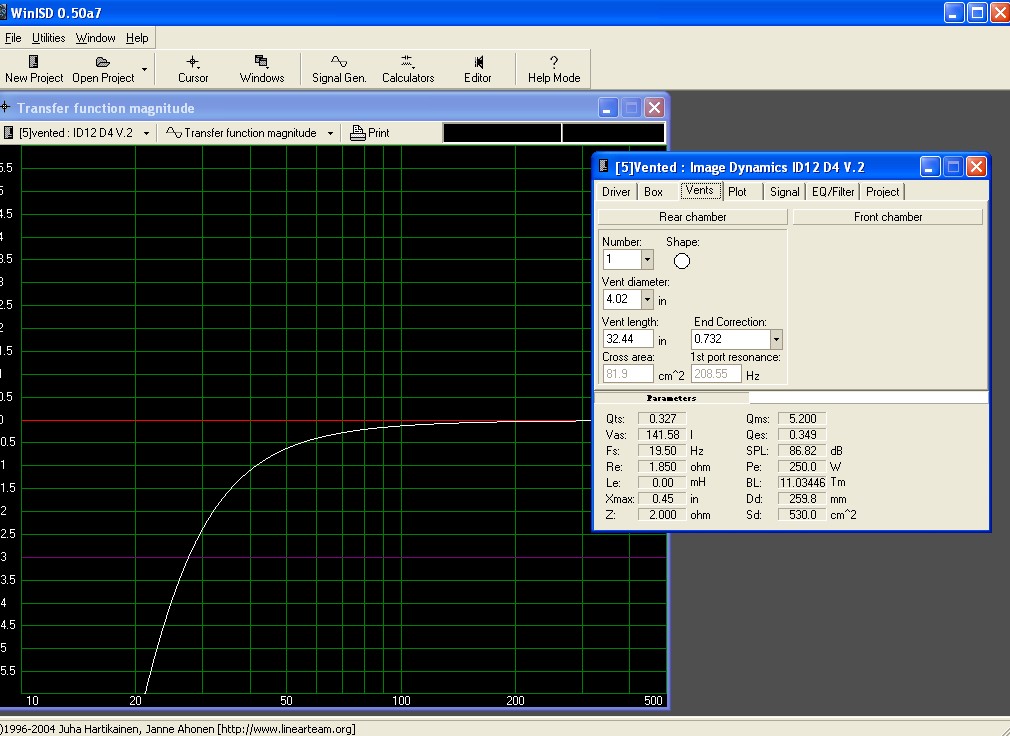

Here is an ID sub from the program's database: ventedwinisd.jpg You see the picture of the sound; there is no peak at all in the response and the low end extension is quite good, with F3 in the 20's. Most of the reason this sub "looks" like it sounds so good is due to its engineering; the rest is due to providing just the right mix of airspace and port airspace to the enclosure. In the pic, you can see the vent diameter of 4" and vent length of 32".
FAQ: "WinISD tells me that the port has to be 32" long. My box is only 18". Now what?"
This is where you work the program to get the best response for what space you have available. This box is also specified to be 2.5 cu ft. If you don't have that much space available you have to make a change there as well. By default, WinISD will calculate a vent opening at 4.02 inches, which in metric terms is 102 mm. This is where almost every user of the program will have to make a change. A larger diameter vent will equate to a longer length, and a smaller diameter vent will call for a shorter length. Use the 'Rear port air velocity' chart that I mentioned in the beginning to see what port noise looks like: velocitywinisd.jpg

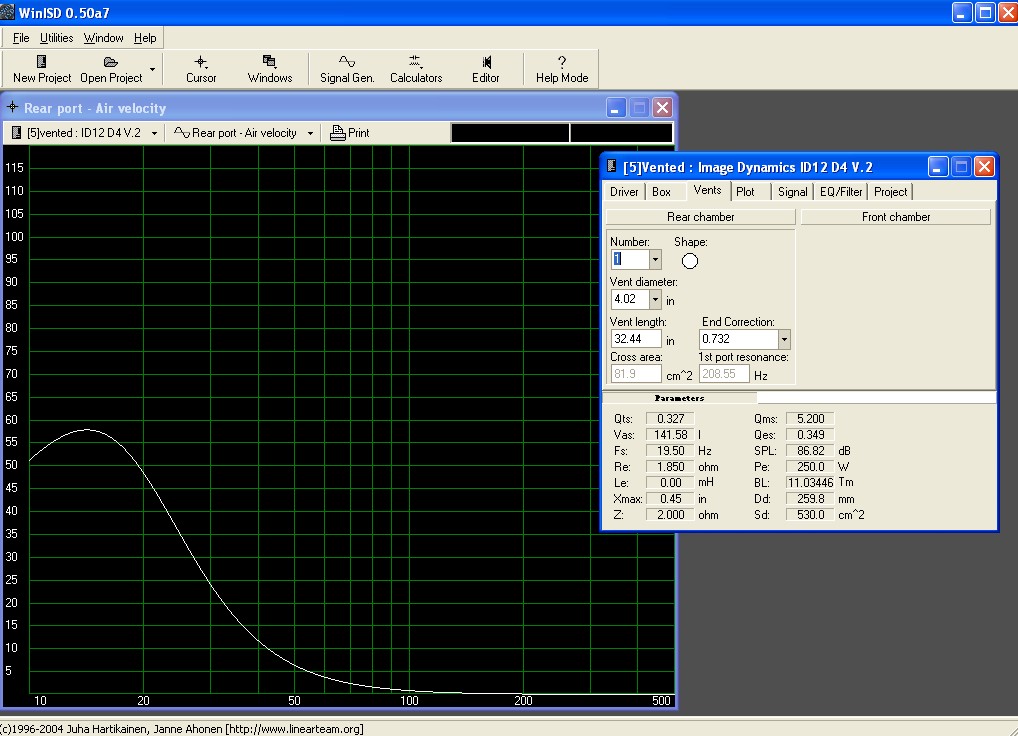

I have my chart shown set to feet/second and specified to show RMS, not peak, output. This pic shows a port noise of 55 ft/sec, which is great for car audio because it is 5% of the speed of sound. You should always keep it at 10% (110 ft/sec) or less. The vent opening area will determine this noise, so making the vent smaller in diameter will make more noise, which might become unacceptable. If you are working along with this guide, you will have to give your sub some power in order to get a port noise response. Select the 'Signal' tab on your working box and input the sub's RMS, or the power that it will be getting, in that block labelled 'Input power'. Now your port noise chart will jump to attention.
So what do we do with this long port issue? How do we get a 4" X 32" port in this box? And what will it do to the overall size of the box? You see that this program allows you to change to a slotted port...is this the best thing to do in this case?
The port, if inside the box, infringes on the air space. It has to be calculated as displacement, so the box has to be that much bigger to compensate for this infringement. I use the cylinder volume calculator on this site to figure volume for a round port tube. If that port takes up .262 cu ft, that volume has to be added to the box volume, making it now a 2.8 cu ft box...and that's just the inside. A round PVC port will take up less interior space than the equivalent slotted port because of port wall thickness. Those 3/4" MDF walls normally used for slot port construction can really add up to some serious displacement.
You have to take all these things into consideration when you finally arrive at what will work for YOUR situation. Fiddle, fiddle, fiddle. Try to reduce the air volume and the port length grows, every time! Make the port opening smaller and the noise grows. In this example, if I were strapped for room, I would allow the port opening to get small enough so that the port noise chart showed me about 110 ft./sec. Fiddle...if I change the opening to 3", the port length shrinks to 17 3/4", the net box air space is 2.5 cu ft, the port noise shows at 105 ft/sec.......and I'm happy with that. The response looks just as great as it did in the first pic and I won't hear the port noise in the car. Done. Build it.
