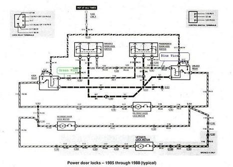

I recently bought a Micro Alarm System by Autoloc for my bronco II because the factory actuators were not working.  I installed the unit and wired the parking lights to flash and the starter disable feature which all seem to work fine.  I have never really wired anything much in my vehicles but figured I would give it a shot.  Well the problem comes when trying to get the keyless entry part of the install to work.  I installed according to the instructions but nothing happens.  Here is what I have
GREEN/ Black Wire (from new system) wired to Pink / YELLOW Wire right before the Locking Relay
Blue/Black Wire (from new system) wired to Pink/Light Green wire right before the unlocking Relay.
Purple Wire (from new system) wired to 12v constant.
WHITE/ Black wire not used
BROWN / Black wire not used.
88 Bronco II Keyless Entry -- posted image.

The system I bought had 4 new actuators, all the wiring, 2 key pads, the module, an override switch, and a led light.  I replaced the actuators and can manually (from inside the truck) lock and unlock the doors now.  The keypads works to flash the parking lights but when I press unlock or lock I hear the module click a couple of times and nothing happens to the actuators.

Ok I tried something that seemed to help.  I grounded the WHITE/ Black wire and BROWN / Black wire that the instructions said not to used just to see what would happen.  Well when I did this the keypad works great to lock and unlock the doors but the door switch doesnt work anymore.  Could someone please help me this is starting to get very frustrating.
