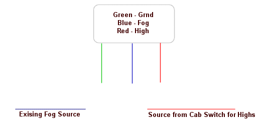

I want to use Fords Upfitter switch inside the cab of my pick up to turn on the high beam circuit on a pair of PIAA lights that include both fog and high beams.  I also wish to wire the low beam circuit to the exisiting factory fog lamp source. My problem is want the fog circuit to turn off if the high beam circuit is energized.  The upfitter switch in the cab is a on/off switch.
Here is a crude attempt at a preliminary circuit...    is this possbile with relays?Fog off when High beam energized -- posted image.

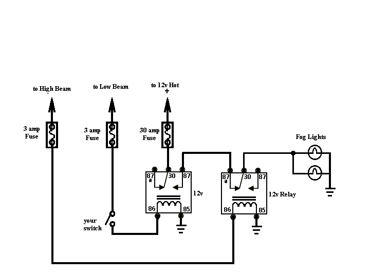

I know it seams clear to you but it is a little hard for me to follow .
You want to use some switch that already has something on it to turn on some lights only when it is switched on and low beams are working and not when high beams are on.
Hmmmm.
This should do it To high beam and Low beam means Existing Circuit in the vehical that has voltage from the headlights right now.
