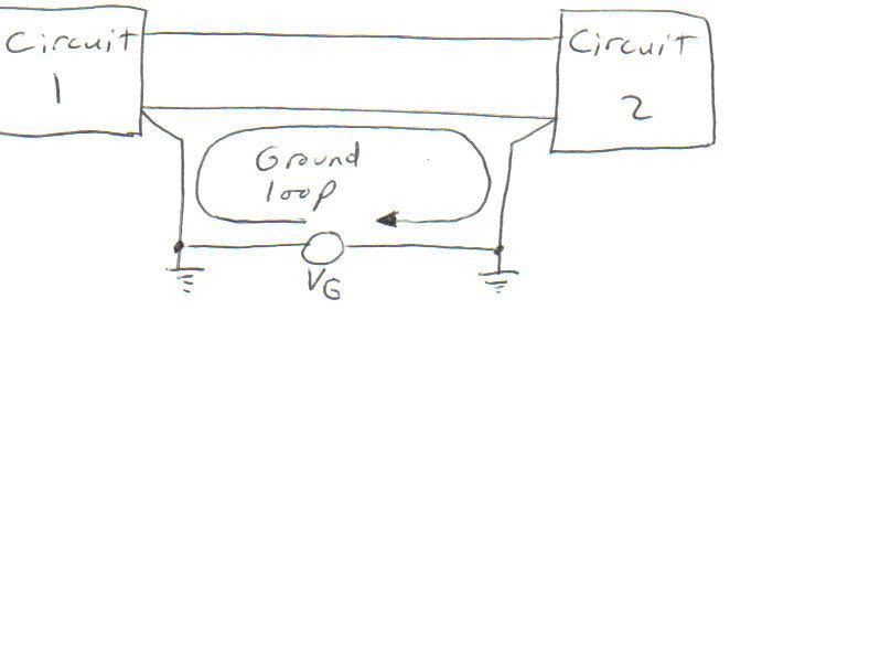

Ground Loop -- posted image.
electrostatic
Copper - Posts: 154
Joined: January 06, 2006
Posted: March 23, 2006 at 5:54 PM / IP Logged
ground loops are created when electronics have poor isolation between their signal ground and power ground. in the above pic assume circuit 1 to be a headunit and circuit 2 to be an amp. they both have poor isolation between their power ground and signal ground, they are tied together. the +12 power wire for both circuits was left out. because of the resistance between the power grounds a noise voltage develops causing a noise current to flow thru the signal ground. this is one reason its advisable to have a single ground point for your audio components, less resistance = less noise voltage. anyways, hope that helps.
