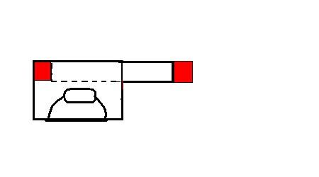

A port can extend from the box, yes.  There are often ways that one could have avoided having such a long port, though.  Usually, it's using too small of an airspace for the driver which resulted in an overly long port, or it's porting a driver that would probably have been better off used in a sealed box.  In car audio installation, customization to fit the vehicle is a primary concern.  One may have just enough space in the car to design a box but with the added displacement of the port it becomes too huge for the space.  In a case like that he could extend the port from the box and fit the contours of the car better without compromising the amount of airspace he wants in the box itself.  It's important to leave an amount of free airspace on both ends of the physical port structure, shown below in red.  Those spaces are actually part of the acoustical port properties (don't end your port opening against a wall).
port placement -- posted image.
