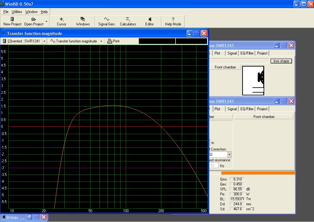

Build a new box, that when complete, will have a net airspace of 4 cu ft.  Included in that box size will be one slotted port built with the dimensions of 10" X 2" X 11 1/4" long.  And some reasonable bracing in the middle of the box...which means that your total box interior volume has to be large enough to account for these (and the two drivers') displacements and end up with 4 cu ft of air dedicated to the woofers.
If you don't have the ability to build this yourself, find someone to hire who is able to build it for you.  Your subs will perform much better than what you are presently experiencing.  Click on the following image and expand it to see what the sound would look like when modeled, but the actual in-car use might be a bit peakier in the middle freqs.  And read my WinISD guide stickied above for more info and how to understand this chart:
Oh, and by the way, 1.25 or 2.00 or even 3.00 cu ft ported for two of these subs would be much too small with badly peaked responses, overly long port lengths and severe loss in the low frequencies.

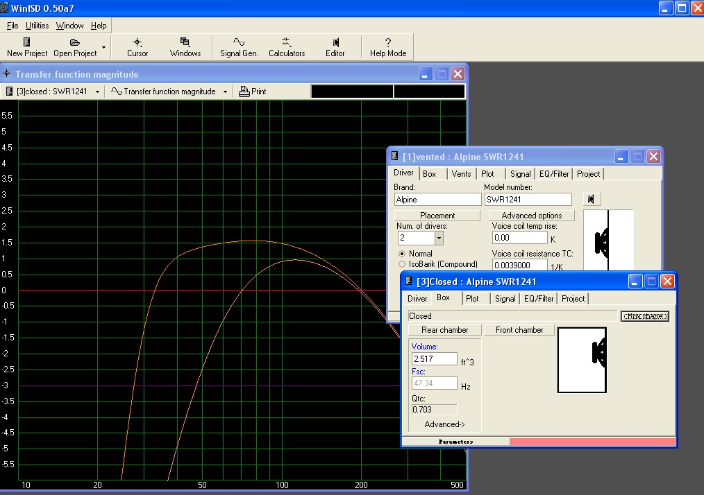

1.25 cu ft is good for ONE of those subs sealed.  For two, a good sealed box would net 2.5 cu ft.  That's why I said to sell the box you have if you've got two subs in it.  Here's a comparison showing the ported (as I linked in the prior post) along with a 2.5 cu ft sealed box:
Just about the entire sub musical range follows a straight line in the vented response.  It doesn't matter that it's 1.5 db above the flat 0 line in this case - that line is where the majority of music sub tones are taking place.  The response doesn't start freefalling until it gets below 40 Hz, and F3 in this chart (for the ported response) would be considered 3 db down from the +1.5 db line, which would be -1.5 db.   When you look at it, you see it hits 30 Hz at that point.  That's ideal for this sub.  I would use a different sub altogether if using a sealed box.
