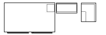

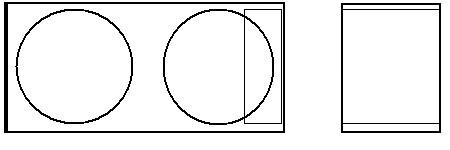

You are right on, arrow12.  A port structure 16 X 5 X 20 takes up much more displacement from an enclosure than 16 X 5 X 4.5.  The box size remains the same but the airspace is different with the two port sizes, so that difference has to be accounted for when figuring tuning freq per air volume, which determines the port length.  If the box were designed with a 4.5 inch port designed permanently inside, but with a configuration that allowed an add-on port structure to be mounted, you could make the switch easier.  And most importantly, the airspace wouldn't diminish so greatly with the larger port structure inside.
Here's an idea of what I mean:
SPL/SQL Interchangable Ports? -- posted image.
