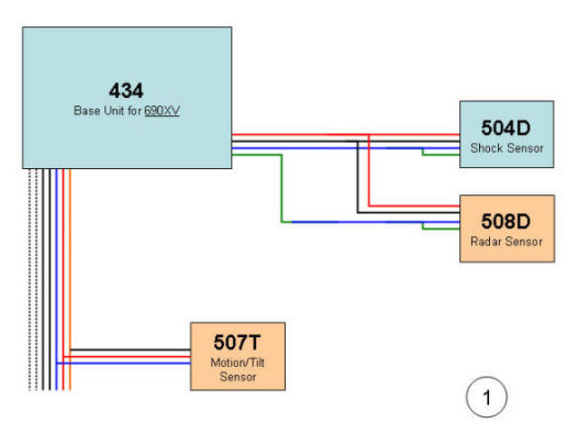

Thanks for these infos! I created two wiring plans to be sure, how to link te wires together. Will nr.1 or nr.2 be the right way to do it?
thx and cheers!
Viper 690, three sensors, Wiring plan? -- posted image.
Big Dog
Gold - Posts: 1,265
Joined: May 02, 2002
Location: Quebec, Canada
Posted: April 04, 2006 at 9:46 AM / IP Logged
The 507 is correct but take a look at the bottom of this page for the 504 and 508 : 504and508.pdf
