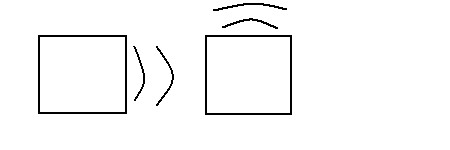

90 degrees out of phase is an "in-between" problem that can't be fixed by reversing polarity on one of the drivers, as an 180 degree out of  phase situation would be.  The cure is to reposition one of the drivers if this out-of-phase issue is a problem.  It would manifest itself as a "muddying" of the sound.

This is what it would look like if 2 woofers were both out of phase by 90 degrees?
i found this animation.
http://www.sfu.ca/sca/Manuals/ZAAPf/p/phase.html
I'm not quite grasping why adding these capacitors puts the speakers out of phase. Is it because it induces lag? Wouldnt both speakers be lagging by the same amount?
