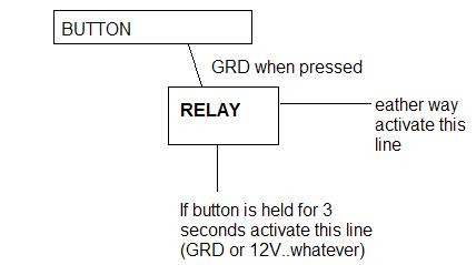

Im looking for a relay or a pair of relays that will do the following.
If there is power or ground on the line for X (2-3seconds) then activate the relay (and then timed for 3-5 seconds....not needed to be timed as I can just add a 528 for this).
Does such a relay exist?
Thanks

Sounds like a 528T will do what you are looking for.  Not sure if I follow what you need, can you clarify?

scarf12
Member - Posts: 25
Joined: September 05, 2004
Posted: April 11, 2006 at 9:02 PM / IP Logged
Looking for a type of relay -- posted image.
Thats exactly what Im looking for...preety much
what this is going to be used for is a sunroof mod... where ONLY if you hold the open button for 2 or 3 or whatever seconds...it then auto opens
I know I can do it by one-touch but Id like to do it like that and have the option of opening it half way etc
