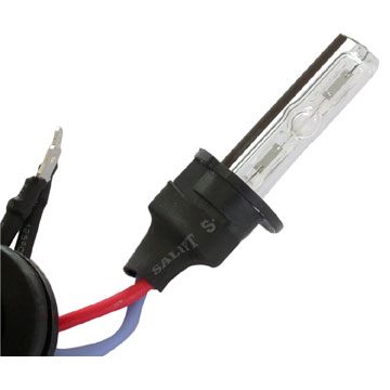

Can you show me a photo of your H3 bulbs?

That is not an H3

Yah, that looks more lid a HID bulb.
