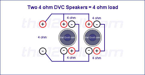

So dual four... here is the option I'd use. Present a 4 ohm load to the amp and call it a day. Although you could wire it down to a 1 ohm load, you instantly run the risk of damaging the amp, and what for? 350 measly watts, not worth it.
difference between dvc and svc? -- posted image.

yeah i iknow if it comes down to it ill either try to get them to exchange the subs for free sence it was there mistake or ill just go with that setup but is there any way to create a 2 ohm load on the amp with the subs i have
dwarren
Joined: December 03, 2004
Posted: April 12, 2006 at 7:57 PM / IP Logged
Nope.
