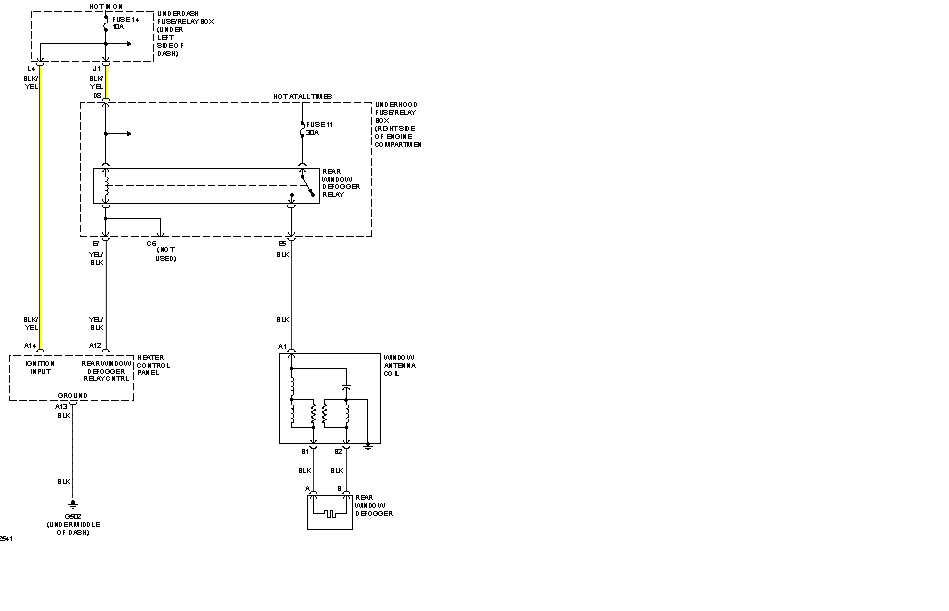

i have a 2003 civic lx 4dr and a valet 562t and am looking for the rear defrst wire. Is there one under the dash that is easily accessible? I dont rreally want to have to take the whole console out and then the radio panel. If you could find one please let me know! Thanks

yellow/ black  behind switch or relay fuse box at underhood fuse box , make sure you programm the rear defroster output to latch/ reset on ignition  since you are using the relay in the car.

there's nothing at the under dash switches? like where the door locks are?

no at the dfoster switch or the realys in the engine compartment fuse box

2 door or 4 door?

2003 Civic Rear defrost -- posted image.

4 door- its a pain to get the radio out. thr plastic is so flimsy and can easily break. thanks for the info.
