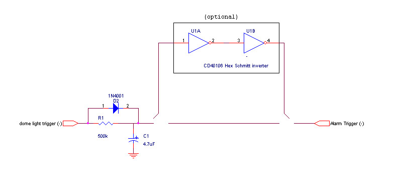

You could try adding a diode, resistor and cap before the input to your alarm, like this-
Need to slow dome activation -- posted image.
This is assuming it's a negative trigger, and the alarm trigger input is high impedance. If it isn't because there are other things hooked up to it, then you can add the buffer to drive it, without affecting the timing.
You'll probably want to play around with the values of the cap and resistor to get the amount of delay you want; smaller resistor and cap values will reduce the delay. If you only need a split second delay, you can use a smaller cap, for example.

Just grasping for straws here- Need to slow dome activation -- posted image.
