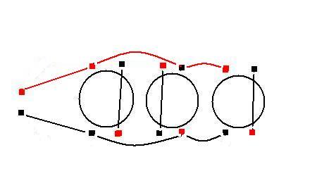

Here's an example of one sub wired in reverse of the other two subs.  This example shows DVC subs, but the concept remains the same with SVCs.  It doesn't matter if one sub is inverted and the other two normal...or one normal and the other two inverted.  You would wire the set this way in either case, because you can always reverse polarity at the amp.  Always find the simplest way to wire the subs knowing you have that 'reverse at the amp' option.  This is series / parallel.  If these were DVC 4 ohm subs the net result would be 2.67 ohms.

Great, thats exactly how Im going to run them. Whats the best way to seal plexi to MDF?
