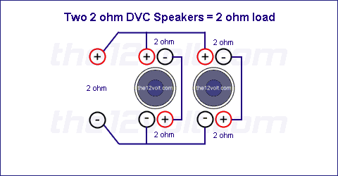

I have two Alpine type- R 1022d dual 2ohm voice coil subs.  Is there any way to wire them together to make a 4ohm load. The amp I am using is an Alpine MRD-M1005 rated at 700watts at 4ohms or 1000watts at 2ohms.

This would be better. Final 2 ohm load. 4 ohm load on that amp for 2 type r's wouldn't push them.
Subwoofer  Wiring -- posted image.

Those subs are rated 500 watts RMS each.  You've got a nice match at 2 ohms.  You'll note that at 12.6 volts the output into 2 ohms is 700 watts and you'll probably not see the 1000 watts at 14.4 volts.  No overpowering concern here.
