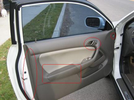

yeah, it's depend on the car, every car is diferent. you have to take a look where i have put the red marks in the pic, i'm not 100% about that but just to give you some idea, like my car it have screw and clips as shown in the red marks.

My door is just like yours Aruman. I will check how it is opened. I will try to buy the popper tools to make sure that I won't damage the clips.

No percyv143 that's not my door that's an RSX door i just took that pic from the net. my car is an Toyota Corolla. so be carefull. sorry for the error.

Ok. My door is just like that. I hope somebody would post the locations of each clip/screws to make it easier. I don't want to damage the door. Thanks again.
